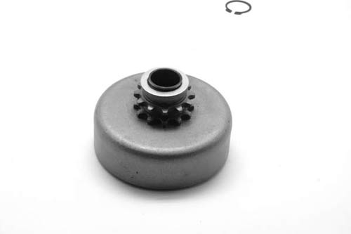

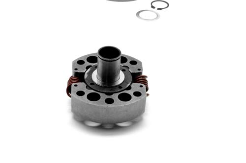

2. Remove the circlip

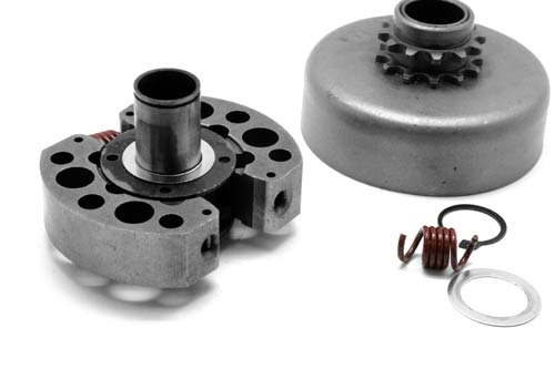

Using the circlip pliers, gently remove the circlip holding the drum to the core. Place it aside.

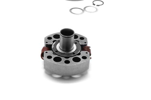

3. Remove the first thrust washer
Remove the first thrust washer and place aside.

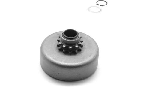

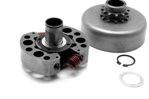

4. Remove the drum
Slide the drum upwards and off the core. Place it aside - watch for any thrust washers stuck to the underside of the drum.

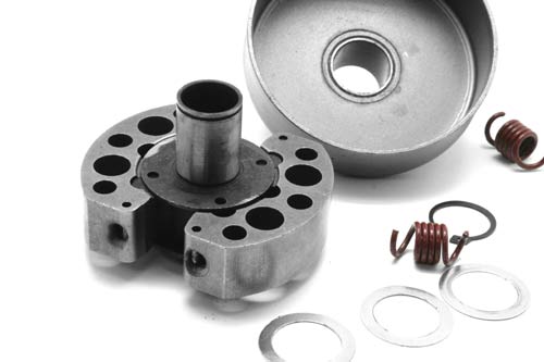

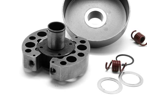

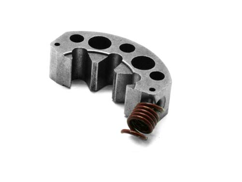

5. Remove the Springs

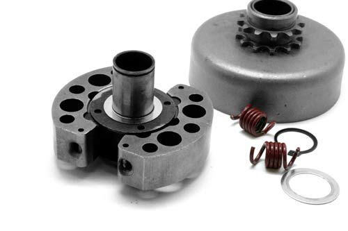

Using the needlenose pliers, gently lever each spring out from one of the shoes firt, then twist and remove from the other shoe. Do this for both sides and place the springs aside.
6. Remove the Third thrust washer if stuck to the underside of the drum
If you've only removed two of the thrust washers so far, there is a third one. It's probably hiding under the drum - flip the drum over and carefully remove the third thrust washer from it and set aside.

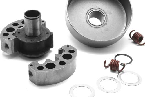

7. Remove the Shoes
Remove the shoes from the core. They will not be attached - they may be a little sticky but should fall off easily. Set the shoes aside.

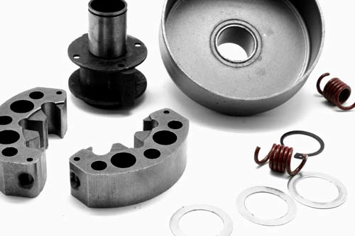

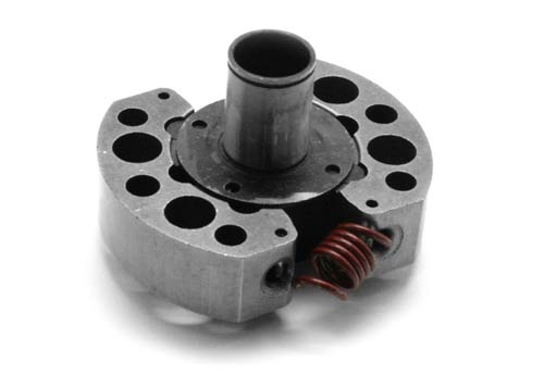

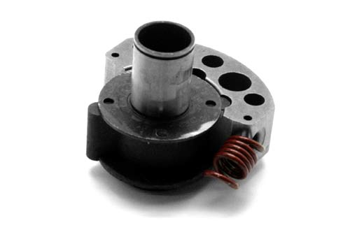

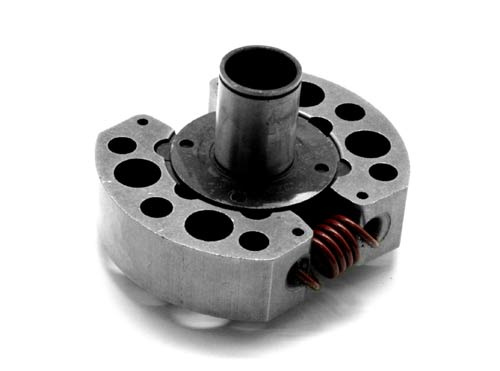

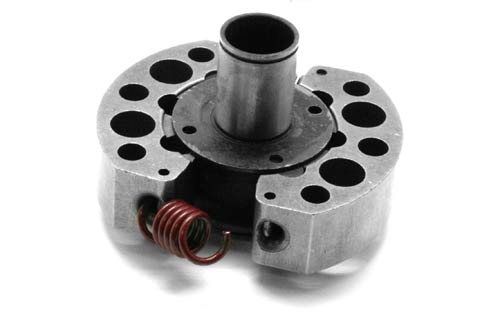

a. First attach a spring to one of the shoes by inserting and twisting it with the needlenose pliers.
b. Fit the shoe with the spring attached, to the core as shown below. You can choose the location for the shoe as you wish. Please refer to the engagement speed and rate chart for ideal positioning of the shoes on the core (click here: http://cutpriceracing.com.au//phpbb3/viewtopic.php?f=14&t=258)
Fit the second shoe and using the needlenose pliers, stretch the spring into the opposite shoe's hole. Do not remove the shoe from the core while doing this otherwise you will find it too difficult to get the shoe back onto the core. Twist the spring until it snaps into the second shoe. If the shoes do not stay in place, try using a rubber band areound both shoes to hold the shoes in place.
c. Do the same with the other spring.

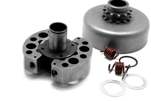

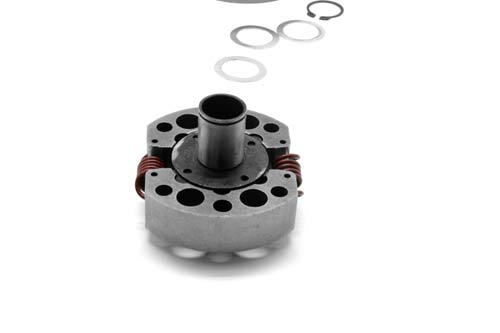

d. Fit two of the thrust washers.
*** SLIGHTLY GREASE the thrust washers before fitting.

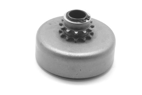

e. Slide the drum over the core. It should slide over easily.

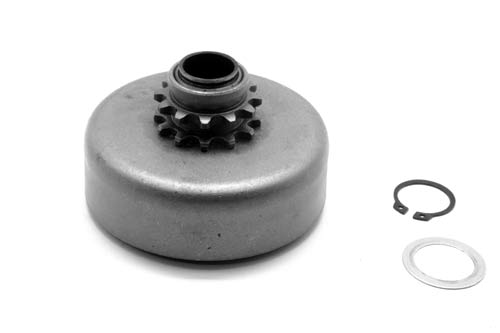

f. Slide the third thrust washer over the core and onto the drum.
*** SLIGHTLY GREASE the thrust washer before fitting.

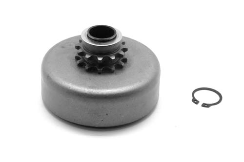

f. Using the circlip pliers, fit the circlip over the core. Ensure it snaps into place and that the drum cannot slide back off.
Congratulations! You have just completed a service of your CPR GT Clutch. Now install your clutch and enjoy!
