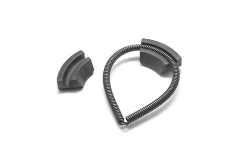

The GT Clutch is a two shoe, two spring system.
It’s really strong, and you can replace all the parts – particularly of interest are the shoes and springs. Different shoes and springs allow you to adjust the RPM engagement speed, as well as the aggressiveness of the engagement.
The springs will take a real beating, and the whole thing can get really hot before they eventually fail. If they do, it will be because they have got hot so many times they become brittle, and snap. Then you simply buy a new set (they’re really cheap) and throw them in and you’re away again!
Also, the corer has two really solid points where the shoe fits in – these don’t break off like the fingers in the SR unit.
