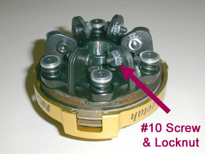

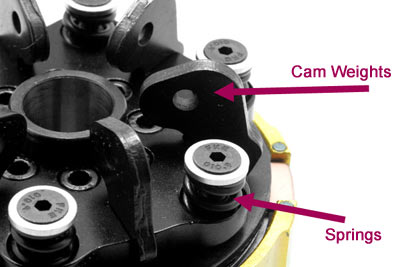

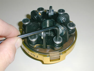

Returning Springs to Stock Setting
1. Remove flat head screw, silver spacer and spring.
2. Install new spring, washer and screw.
3. Tighten screw so until the top of the screw is .41 inches in height as measured with a caliper.
*NOTE* This is approximately 5 full turns back out from fully tightened position.
4. Install on kart and check engagement.
5. To raise engagement turn all screws the same amount clockwise.
to lower engagement turn all screws the same amount counterclockwise
