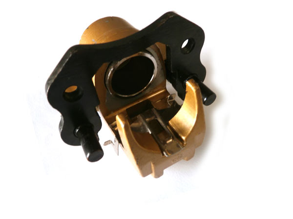

Remove the calliper from your vehicle. Place on a bench with the bleed nipple facing downwards as shown.

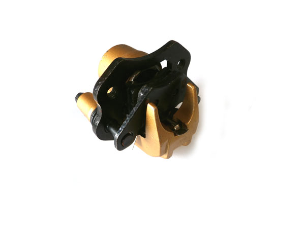

Push the large black bracket with the two holes and pins back toward the rear of the calliper until the pad attached to the other black bracket is sitting right at the end of the pins, then push the top of that bracketted pad towards the rear of the calliper and wiggle it over the pins until removed. Sometimes it's tricky, but a bit of practice will get you there.

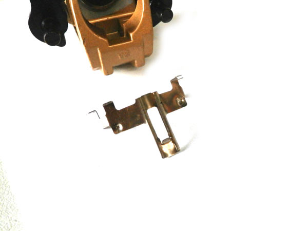

Remove the rear pad (small pad)
Remove the metal spring, clean.

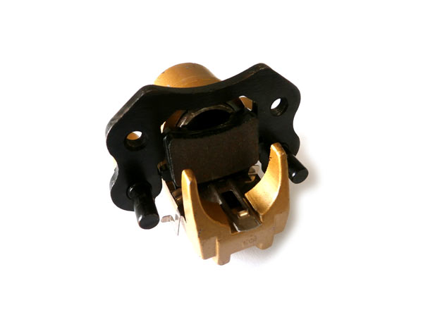

Replace pads in reverse order as shown.
