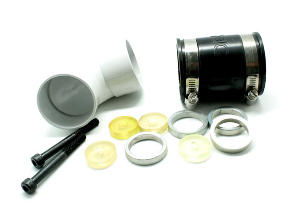

Pack contains:
2x M8 75mm High Tensile Bolts
4x Alloy Spacer Rings
4x Nylong Spacers
1x 90 degree bend
1x Rubber joiner sleeve

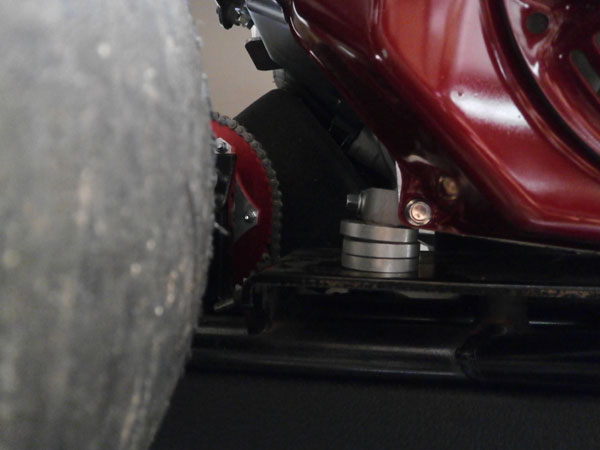

1. Remove the exisitng engine mount bolts from your mounting system. Replace the two rear bolts with the 75mm bolts supplied.
2. Add 2x Circular Alloy rings and nylon spacers to each of the 75mm bolts you've installed.
3. Replace engine & pre-tighten all bolts - set up chain tension and tighten completely.

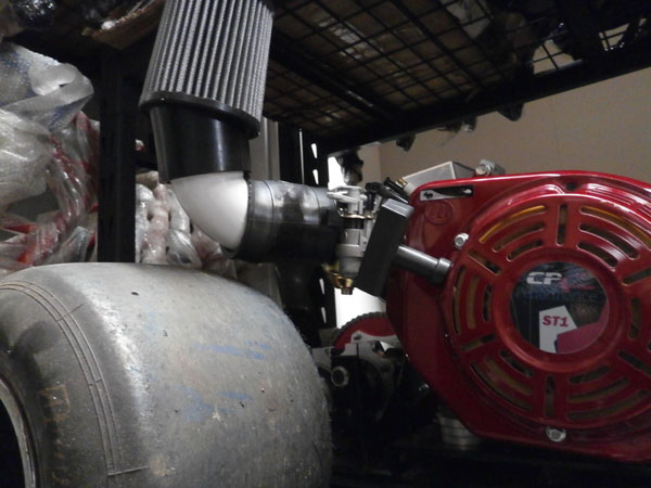

4. Remove air filter from venturi
5. Install Joiner sleeve (with clamps loose) - this will fit very tightly over the venturi and the white 90 degree bend.
6. Install air filter with clamp and position as per picture or own personal requirement.
7. Tighten clamps.
